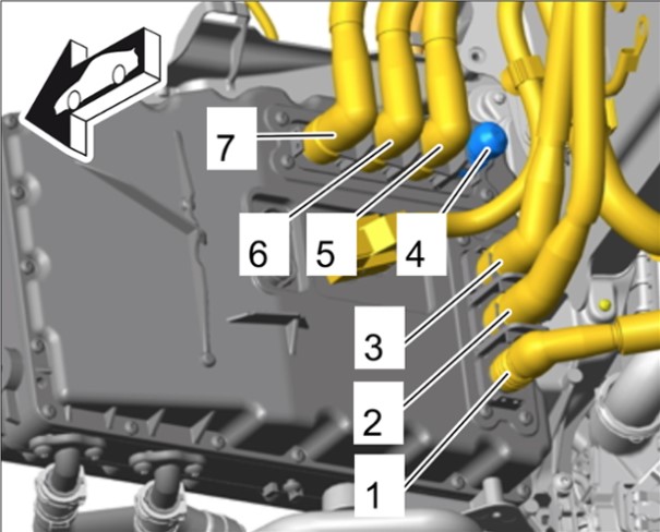

97061131101 Соединительный кабель
Блок силовой и управляющей
электроники электропривода
Компрессор
КЛИМАТИЧЕСКАЯ УСТАНОВКА
высоковольтный провод -1- компрессора кондиционера на силовом электронном блоке (быстроразъемная муфта)

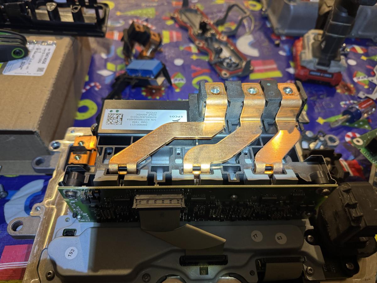

18.11.2025, 16:46   #30
rcojoe
[QUOTE=max_d_ua;174999]Thank you for your reply. Getway can give such a picture: m1437: ? In the parameters of High-Voltage Power Electronics, if you look at the phase current of the motor, it is present in a negative value, and that at the time of winding, what is further during operation. further it is also confusing that after the sledging, the car often starts not the first time, but you can hear as if idle scrolling of the electric motor, from the second time it always starts. replacing the electric motor is of course global... can a faulty inverter behave like this?[ /QUOTE]
Инвертор измеряет ток двигателя. Вы можете увидеть зажимы амперметра на верхней части инвертора.
