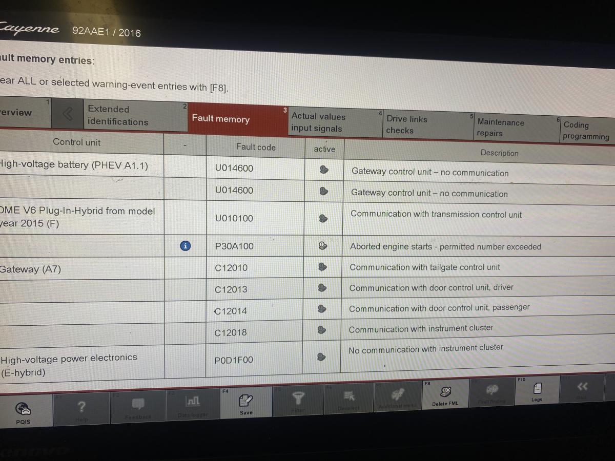

03.04.2021, 14:58   #61
Momo59000
Any help please
03.04.2021, 18:17   #62
Momo59000
03.04.2021, 19:41   #63
Is there any non-standard equipment on the machine?
https://forum.cayservice.ru/showthre...hlight=P068A00
03.04.2021, 19:46   #64
Repeat the entire procedure sequentially
https://forum.cayservice.ru/showthre...F+%28Hybrid%29
